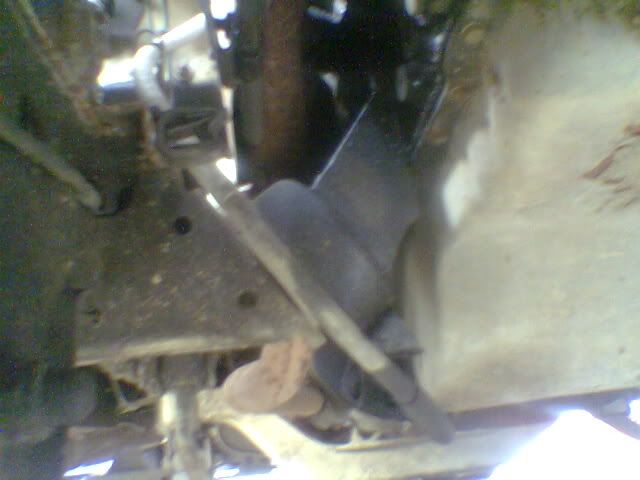

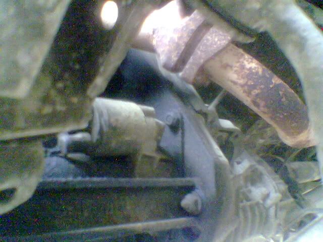

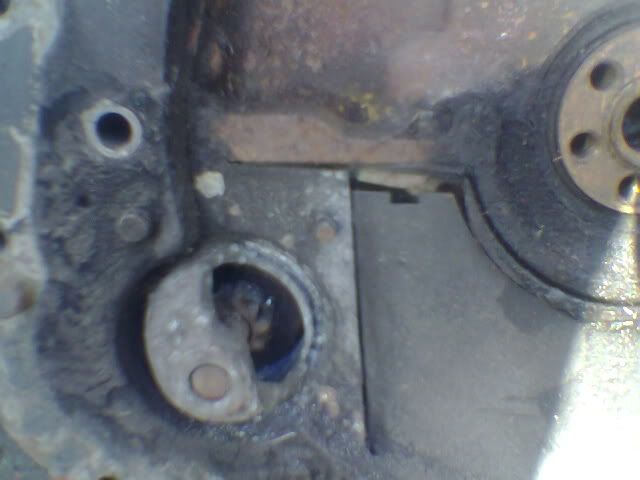

Postby madvanman » Wed Oct 05, 2005 6:17 pm
here are a couple of pics tha might be of interest
drivers side engine mount
Passengers side engine mount note brace from mount to bell housing

My 2.9 engine is mounted slightly offset to the drivers side of the engine bay.

Postby Luke » Wed Oct 05, 2005 8:08 pm
I actually went up to me garage at the weekend and forgot to dig out and measure those plates, soz :oops:
Great piccs MVM!!! :D
whats that bit of plate near the starter motor? :?
and is that the top half of the mt75 cover behind aswell?

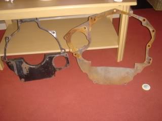

Postby Luke » Sun Oct 09, 2005 8:20 pm
Havent forgot!!! :D these are the 2 plates to get an idea of whats involved!!
Di on the right and V6 cologne on the left!! :lol:

Postby madvanman » Thu Feb 09, 2006 3:07 pm
Luke wrote:I actually went up to me garage at the weekend and forgot to dig out and measure those plates, soz :oops:
looks like a spacer/adaptor for the starter motor
